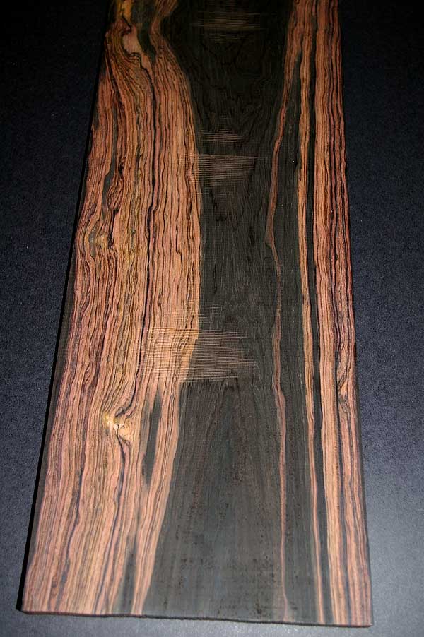

Anyone care to take a stab at this one ?

Brazilwood? Just kidding How about cocobolo.
PostPosted: Wed Aug 24, 2005 10:41 am
I was thinking that Bob because of the pattern, but I never saw coco that colour ?
PostPosted: Wed Aug 24, 2005 10:42 am
The Colours more like EIR but I guess you don't get that in Brazil
PostPosted: Wed Aug 24, 2005 10:53 am
Posts: 2220
dalbergia nigra?

I agree with Brad...Brazilian Rosewood, Dalbergia Nigra.

I would guess BRZ as well.

Me too.

I have a piece of BRw that looks just like this

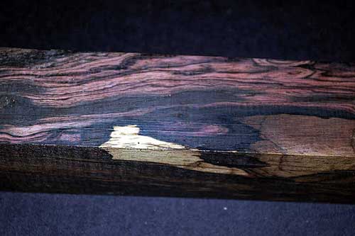

Brad, Shawn, John and Michael...you are correct. The locals here call this "Gaviuna" which is their name for this distinctive BR with the purplish characteristics. I traveled to a guys house yesterday who was once a supplier for furniture makers. A friend of mine here told me he had visited his business a few days ago trying to sell some woods he had left over from many years ago. He had Imbuya, Mahogany and the normal stuff but, he said he had a little "Gaviauna" but wasn't sure how much. So, my wife called and spoke with him and he said come on out and he'd separate what he had. Most of it was small turning squares..1" X 1" and 1" X 2" ranging in length from 1' to 4'. However, he had a few larger pieces too. All so oxidized it looked like ebony. I told him I didn't have a use for the squares but, would buy the larger pieces. He agreed. I couldn't wait to hit it on the planer. When I did the smell knocked me down it was so pungent and it sounded like planing glass. Some pieces were this "Gaviuna" which I got 4 classical sets from. I only had enough off two other pieces to build a couple of dreadnoughts that are "BLACK". As black as any ebony I've ever seen. He said about 60+ years old. Just thought the color of this might stump you. I've seen the purplish casts in BR but, not this dominant before. I got it cut into sets last night but, my thickness sander isn't finished yet, still waiting for parts to arrive from the US. Could take a week or more but, when I get it sanded down I'll post pictures of the sets. Good work guys..you know your wood. Heres a piece of the block...Beautiful huh ?

Don't guess they call it Dalbergia Nigra for nuthin'!
Pretty stuff.

Its Brazilian... often when its freshly cut it exhibits similar colors, which in turn change with oxidization or somesuch.

Brazilian rosewood-100% sure

The smaller 1x2" sticks would be good for bridge blanks.
The longer that BRW oxidizes the darker it gets...the blackline sections of the sample at the top are the giveaway when identifying BRW...other rosewoods will so similar but you see black, sapwood, and spider-webbed heartwood all next to each other, chances are it is BRW.
What the locals are calling Gaviuna maybe be confused with Caviuna. Caviuna is a name that is sometimes applied to BRW but also is used when referring to Pau Ferro. To confuse things more, In Bolivia Pau Ferro is called Morado. People have also over the years refered to BRW as Santos Rosewood which is also usually Pau Ferro.
A recent controversy is whether people have been selling wood as Caviuna and shipping BRW which would violate CITES. There are alot of Spanish luthiers that refer to the wood used for their backs and side as Caviuna, so as to not tip their hand that it is really BRW. Others have bought Caviuna, expecting BRW only to receive Pau Ferro...
